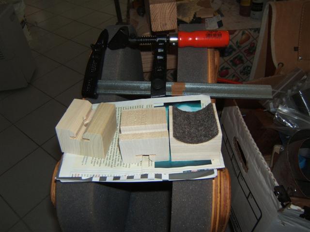

Stew mac has a new "Press Clamp" that alows you to press the frets in over the extension. I bought one, but have not tried it yet. It comes with three cauls to fit a wide variety of instruments. Basically you tighten down the clamp ( like a regular Bessey clamp) and the fret is seated with the help of a brass caul that matches the fret board radius. Great idea when you simply don't want to hammer on a delicate extension (even with a "dolly" in side). I also bought one of LMI's new "dolly's" that Frank Ford designed. It too is simply ingenius! These guys never stop comming up with great solutions. Here are a few pics of tools I use depending on the situation at hand...as you can see some don't get used too often ( very heavily covered in dust):
